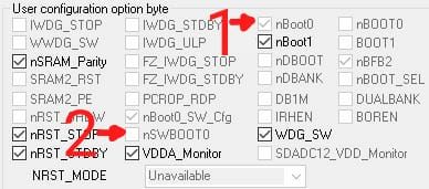

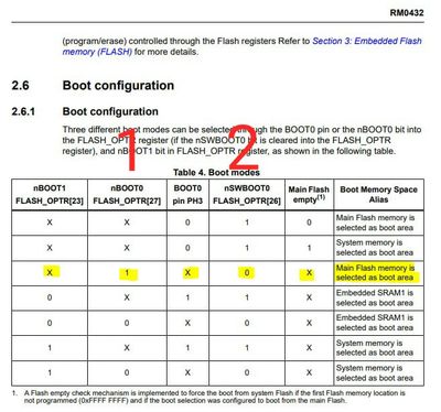

Hi.I am using MCU STM32F070CBT6TR on my custom board, I do use ST-LINK/V2 as hardware tool, and I have configured the boot options according to this: But in fact the MCU is not running the code, it keeps in lockup state, and then I am not able to deb...
