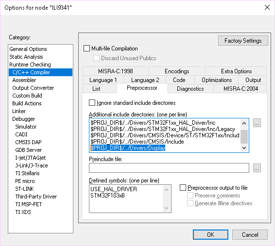

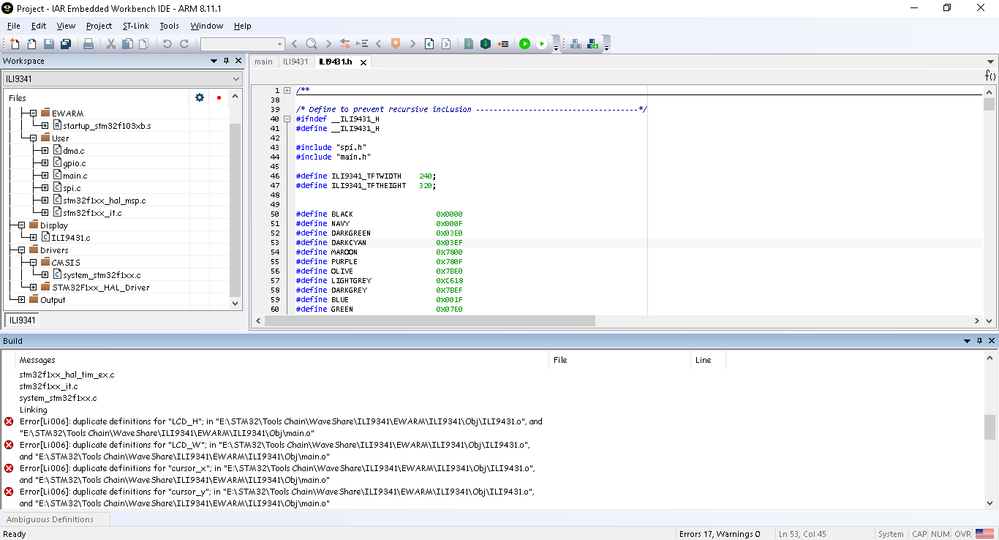

2017-06-03 2:01 AM
Hi mich.lei
In before, I am testing all(every related LCD) code in ''main.c'' and it work fine in compile.
I move all code and relative reference(include & define) to separated file(ili9341.c & ili9341.h).
Of cause, the preprocessor has updated with location for them.
Unfortunately, there have error in linking and show below.
Please help me and give me your comment.
BR
Lewis
2017-06-03 7:52 AM
I am afraid I can't help you much with linking. I just fight back when my IDE does something odd. Besides, you seem to use different IDE than I.
If you have a IDE/linking problem, why don't you start a new discussion about that?
