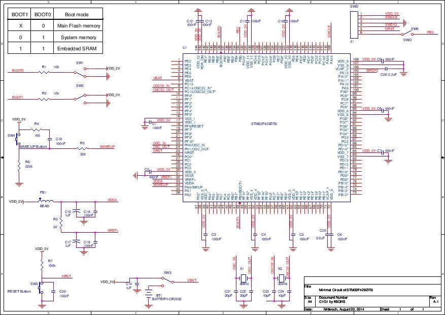

There are no libraries for schematic symbol of STM32F429ZIT6 online. It took me some minutes to create pinouts for LQFP144. I prepared some files with pinouts and schematic library for STM32F429ZIT6 with LQFP144 microcontrollers.
Here I made the basic circuit of STM32F429. But it is not really minimal circuit. Some components can be eliminated to get the mini circuit. Here

Do you have a link to this original schematic? The PDF link also does not function any longer.
