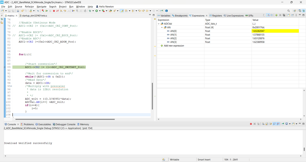

2024-04-08 10:29 AM
@###### @Uwe Bonnes Thank you for the insights.
As you can see the code.
1.I switched to single sample mode.
2.I have enable the SCAN mode bit in the ADC1.
I expect that on each Start of conversion I read the ADC in the set sequence, however it is just sampling the samething. I am not clear,where am I getting it wrong.
Please guide me what can I check?
Thank you
2024-04-09 2:28 AM
I would check using a debugger that the ADC Peripheral registers are being written to as you expect. Sometimes peripherals need to be enabled before the register contents will accept changes.
Also I would ensure your sampling cycles are correct. This is the period to wait in clock cycles before a valid reading can be taken and is in the Sampling cycles in ADC->SMPRx registers.
Also, try reading AN3116 if you haven't already.
This gives a good description of the ADC modes and may help your understanding better.
