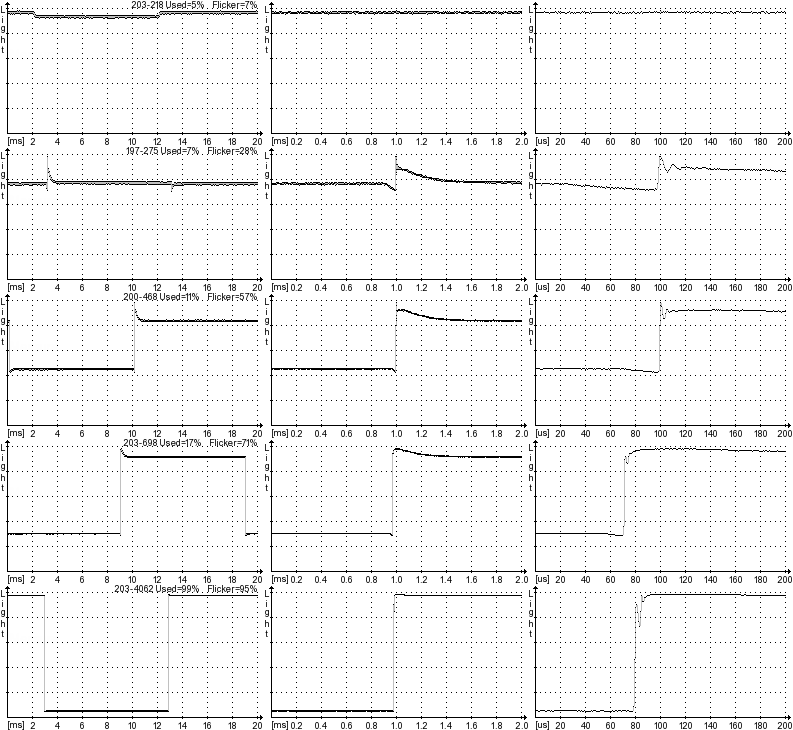

}#1 Slow rising

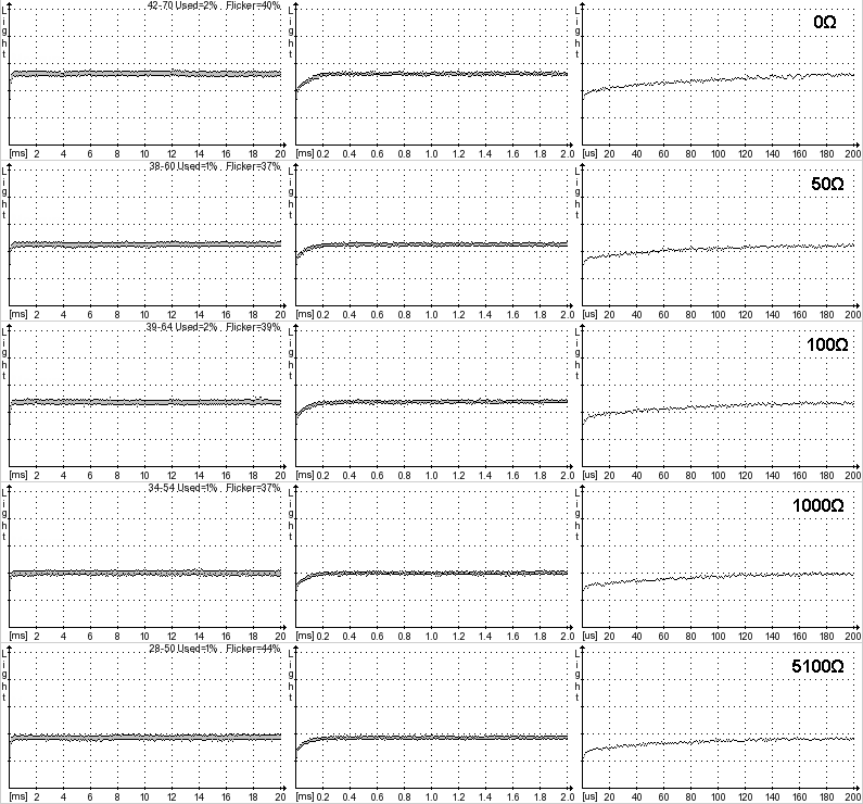

I early discover that the first sample seems to be lower than the others. However after looking at curves I noted that is was more than the first sample. Signal is slowly rising. I have made a workaround for this, by sample 1000 extra sample and discard them. The picture show with different serie resistor on the analog input. This is from prototype no 1. The second have different DC level (around 200).
#2 DC offset

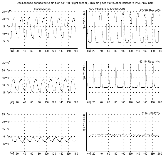

It is some kind of DC offset. DC level measured with oscilloscope isn't that low from the ADC. I think that this mysterious DC offset level keep the ADC from see low level signal and therefor give curves like this:
The level is different betwen the two prototype boards I have and seems to differ if I change the RC filter in front of ADC input pin.
#3 Overshoot
It will for some level of signals be a heavy overshoot in the curves from the ADC. Note that the 50 Hz square wave signal to the ADC isn't straight square wave. It is bandwidth limited by the light sensor. So the upper corner to the left of the rising signal shouldn't be sharp, it will round off little like the curves down to right in the pictures. However overshoot and ringing as in these curves shouldn't exist. These cuvres are from prototype number 2 and the DC offset differ from previous curves above.
What have I done wrong?

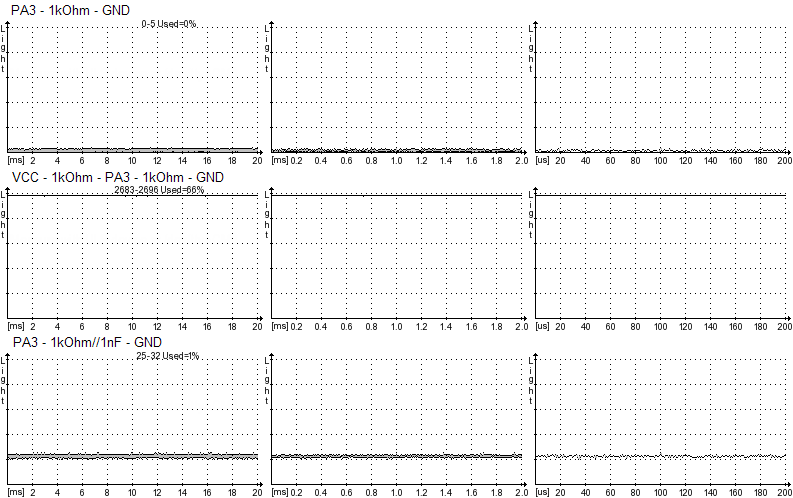

More investigation of the DC offset. I remove the light sensor and instead mounted a resistor of 1kohm from PA3 to GND. This give a level close to zero, as can seen in picture below. I added a resistor to VDD and got a straight line at 2683-2696, which corresponds to 1.64 volt. It seems good, half of 3.3 volt.
Now I got an idea of measure with an oscilloscope at the analog input (with only a resistor to ground). It looks like this, while the ADC is working:
Where does this signal come from? Please note the high level (0.5 volt), at 1kohm load.
Is it this that destroy my measurements. Can it build up a DC level. Let us mount a capacitor over the resistor at PA3. The result can be seen in picture above at the third row of curves. Yes, a DC level is measured by the ADC.
How can I avoid this?
//Michael
2021-12-28 6:24 AM
> hAdc.Init.SamplingTimeCommon1 = ADC_SAMPLETIME_3CYCLES_5;
The sensor you have has a very high output impedance. You should increase the sampling time to improve accuracy.
What is the hardware setup difference between "PA3 - 1kOhm - GND" which gives the expected result and "ULS P1 PA3 - 1kOhm - GND" which does not?
I would imagine most/all of these are artifacts from the sensor and not the ADC.

I mounted an OP and got better results. Now low levels are visible and no overshoots. It looks like curves I'm used to see from this sensor, then it is connected to an oscilloscope. I connected the OP (MAX44259) as a buffer between the sensor and the ADC. Between OP output and ADC input is a resistor. I believe this resistor is needed to reduce the peak current at sample time. I mounted 470 ohm and think that is good, since datasheet specify max 680 ohm for the configuration I use. I already have 100 ohm resistors in the design and was on the they to select it for this position also. However I think it is better with higher value, to reduce the current. I will experiment with different value to see if it effects the sample values. I will also test to load the OPT101 output. Right now it only goes directly to the OP input.

Regarding the DC offset that can be seen in the curves. In the first picture it was caused by the current spikes from ADC, capacitor on input pin and the lack of sink capacity of the signal source. In the last picture above, the dc offset is actually from the source. The light sensor don't go down to zero. In one curve the sample values are 10 to 18, which correspond to 6.1 - 11 mV. The light sensor is specified to have 5 - 10 mV dc level at dark. So now all looks good to me. However I wan't a faster light sensor, so I will replace OPT101.
