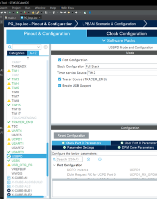

Ive turned on the following:

@Nicolas P. Im adding the .ioc file

You may need to share the full project. According to your IOC, you are using full stack configuration for USB PD application not type C only as you mentioned in initial post.
