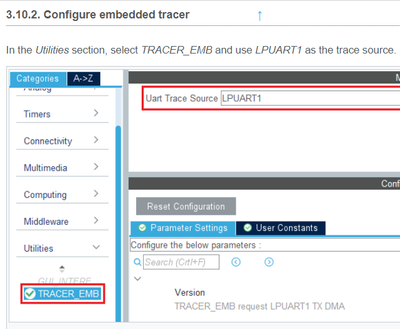

You need to configure a LPUART and an utility : Tracer_emb as on below picture.

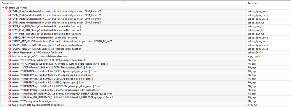

@Nicolas P.
I get these errors after generating the code
