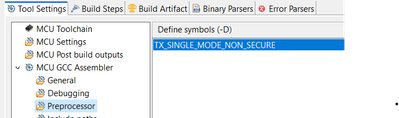

regarding the missing functions you mention (_tx_thread_secure_stack_context_save, etc), did you define TX_SINGLE_MODE_NON_SECURE for C compiler AND also for the assembler ?

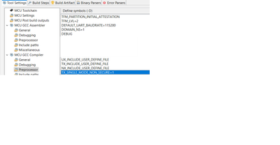

Hi Guillaume, I was doing one silly mistake. Actually I didn't included TX_SINGLE_MODE_NON_SECURE for the assembler.
Now,
tx_thread_secure_stack_allocate/_free.c, txe_thread_secure_stack_allocate/_free.c, tx_thread_secure_stack_initialise/_build.s included(as I am able to compile my code.

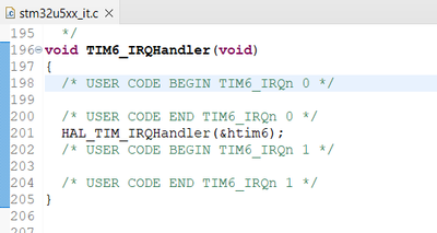

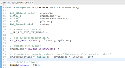

TIM6 should be higher priority than PendSV (so for example 14).
