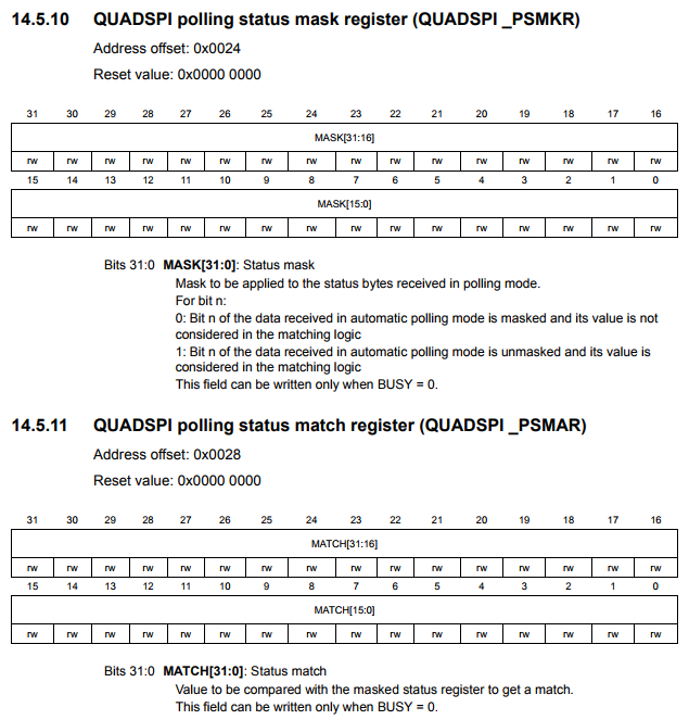

QUADSPI polling status mask register (QUADSPI _PSMKR)
QUADSPI polling status match register (QUADSPI _PSMAR)Mask and stencil for checking the flag in automatic mode of infinite reading.PSMKR - the mask resets all the irrelevant bits when reading the flag, PSMAR performs the XOR operation with the result = if there is a complete match, the interrupt will occur. Any other value that does not match the mask and the stencil is ignored.2018-02-17 4:13 AM

Mask and stencil are applied to the full width (it is desirable).
Memory responds in a loop all the time, it's not one byte - but 4. It looks something like this:mask 0x01010101 - the remaining bits will be resetstencil 0x00000000 - wait for the answer to match (your case is now 0x01 -> expect 0x00).If you want to control two bits or more - they all need to get into the mask, even if they are at the start zero.
The mask is a binary operation '&', the stencil is a binary operation '^'.An additional problem is the direction of reading the bits (high / low). In this problem, you can easily lose the goal. The easiest option is to catch the answer during debugging (it might surprise you). The way it will look - it's easy to build a mask and a stencil.

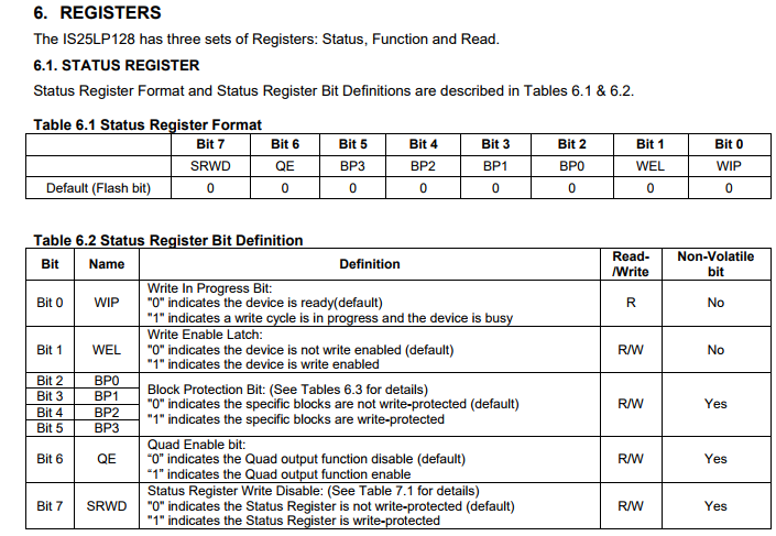

for check WIP bit I used:
QUADSPI->PSMAR = 0x00000000 ;
QUADSPI->PSMKR = 0x01010101 ;
but for check WEL bit I used:
QUADSPI->PSMAR = 0x02;
QUADSPI->PSMKR = 0x02;Can anyone describe the use of PSMAR and PSMKR?
2018-02-19 5:19 AM
I already said how it's done.
There is no point in understanding, there are a lot of conditions and confusion. It is much easier to read the answer in a simple way, it will look exactly like this - how you need to process it. The status response always has a size of 8 bits, and it repeats in a loop until a clock signal is sent to the memory chip. (First, you need to give the status reading command.) But the answer may differ from the documentation, primarily externally. A WIP can be the first least significant bit, or maybe the most significant bit. I abandoned the idea of guessing, it is easier for me to consider the answer from the debugger.You got a cast, and WIP is in the low bit. In this case, you need to reset everything except PSMKR 0x01010101. Now you can catch the necessary condition for you WIP = 0 PSMAR = 0x0, WIP = 1 PSMAR = 0x01010101.
