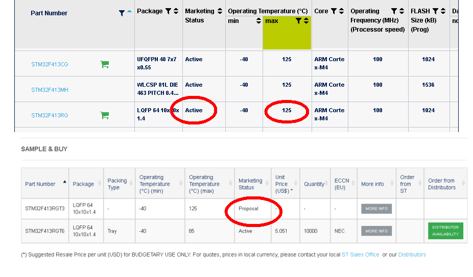

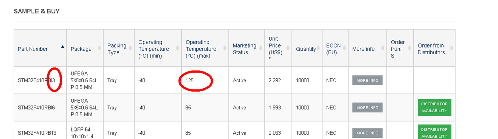

2017-04-05 3:33 AM
complete list
/external-link.jspa?url=http%3A%2F%2Fwww.st.com%2Fcontent%2Fst_com%2Fen%2Fproducts%2Fmicrocontrollers%2Fstm32-32-bit-arm-cortex-mcus.html%3Fquerycriteria%3DproductId%3DSC1169%24%24962%3D125%7C125
I have used the same filter on that table. Sadly, it does not indicate real availability at the ''garage-scale'' distributors.
And not only that:
I understand why, it's just that it's again misleading and does not help in searching.
I don't try the ''selector'', as I won't install Java (wonder why would that need to be so).
2017-05-22 9:11 AM
Hi Jan,
The selector is behaving in a way that it marks a line as active as soon as at least one given device belonging to this line is active.
This is the case for STM32F413RG.
-Amel
2017-05-22 10:47 AM
Hi Amel,
Thanks. As I wrote above, I understand why is it so; I just said it may be confusing.
Jan
