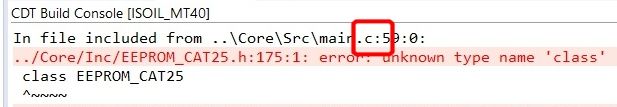

2018-10-22 11:13 PM
Hello everyone,
Yes Atollic use GCC compiler, is one of the options provided by CubeMx code generator.
Compiler error is simply due to "calss" call not recognized.
I tried to import an SPI EEPROM library from Arduino repository.
So, I can extrapolate individually functions but I think C++ libraries are powerfull.

2018-10-23 12:49 AM
That still doesn't tell us what "error", exactly, you got - and what, exactly, you were doing to provoke it.
So it doesn't help to resolve the issue.
You need to show the relevant part of the source code, and the full text of the error message.
Use copy & paste.
Use the 'Code Snippet' button for source code:
Have you told the compiler to compile as C++ ?
Usually, the source file extension - .c or .cpp - will select 'C' or C++ mode, but can be overridden by options...
2018-10-23 1:39 AM
2018-10-23 1:40 AM
2018-10-23 1:46 AM
As I said, the .c extension on main.c tells the compiler to compile is as 'C' - not C++
Clearly, the 'class' keyword is not valid in 'C' !
If you're going to have part of your project in 'C', and part in C++, I think it's generally recommended to make your 'main' a C++ file.
This is general - not specific to STM32 or GCC.
