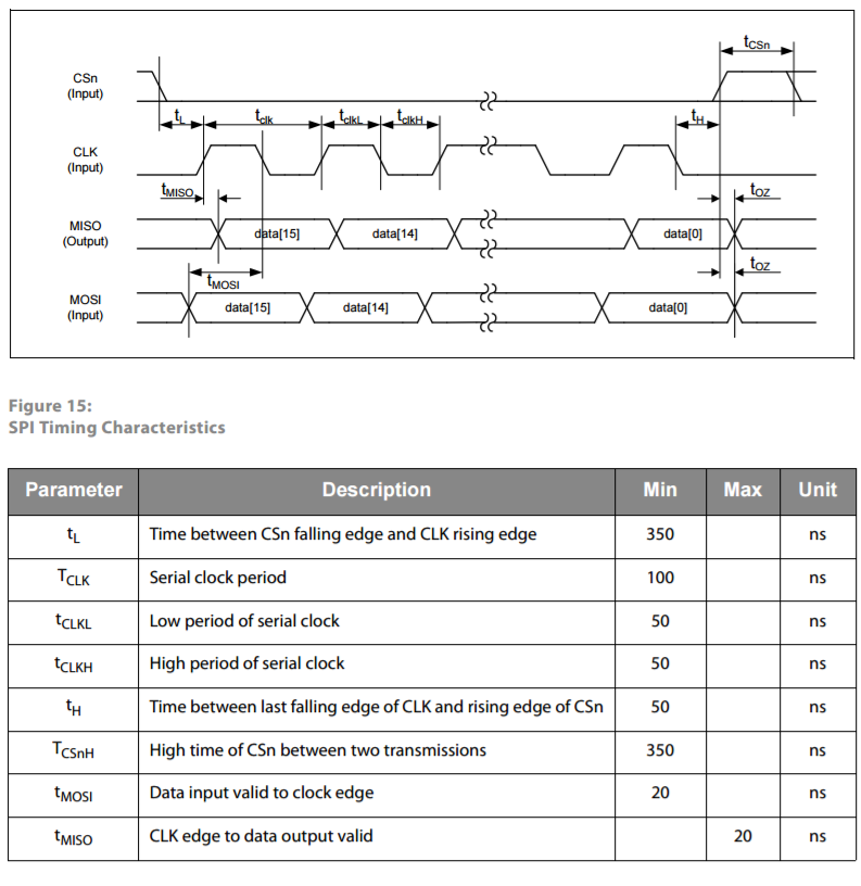

The AS5048 datasheet has some clues.
This puts the clock at fmax = 10MHz, but also check t_L. Anyway, doesn't make sense to read at more than 10kHz because that's the sampling frequency of the angle output.
I found it's best to use the minimum output speed setting that works. Otherwise you start getting reflections when you use longer cables that will make your readings erroneous. This setting is how fast the pin transitions, which of course at higher clock frequencies you'll need it to be higher. But bear in mind that if you're going to use long and uneven length cables it's best to keep it slow.
