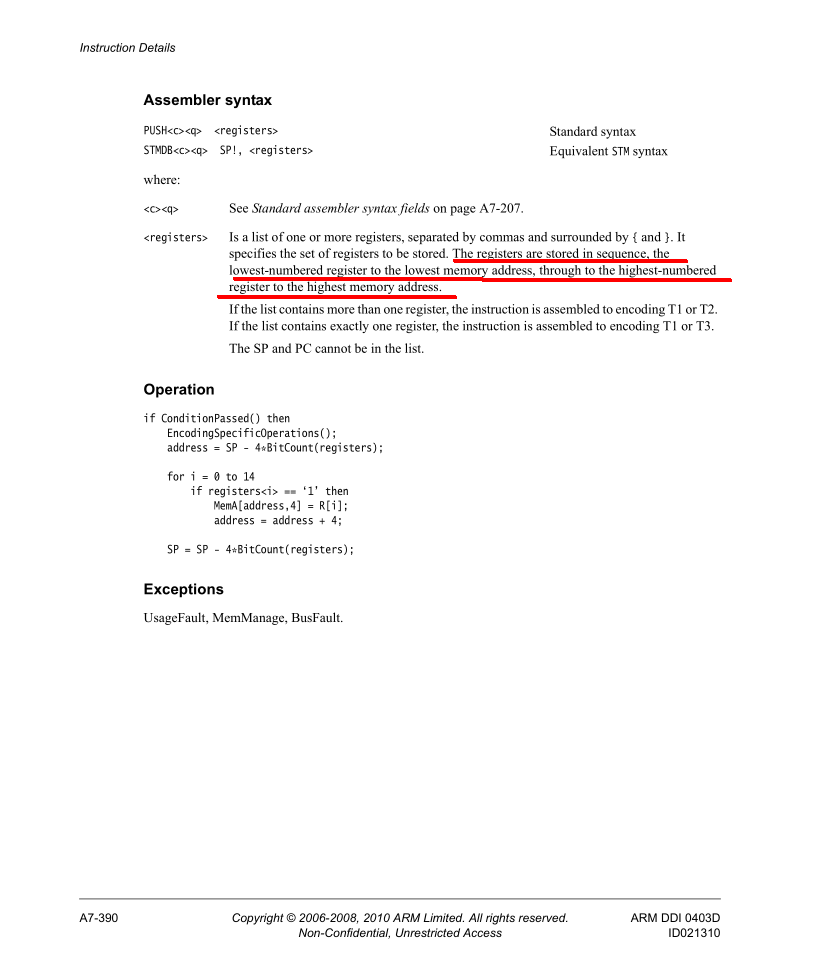

The processor does not work as you'd think, but it works according to its specification:
As it's PUSH where you don't have the registers in ascending order, you should've seen the "incorrect" (or unexpected) order of values on the stack.

And after reading your answer I have switched the orders of the registers when pushing them and now it works :D. Thank you! I was not aware they are pushed in ascending order I thought they are pushed and popped as I write them.
The snapshot you posted is from the ARMv7-M Architecture Reference Manual, correct?
2021-05-31 1:13 PM
Yes.
