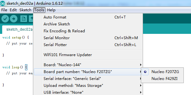

2018-01-03 1:51 AM
Thanks very much ,
https://github.com/stm32duino/wiki/wiki/Getting-Started ♯ upload-method
I need to use the DFU Upload method, but I can not find it in ardunio Upload method ??
2018-01-03 4:32 AM
Hello
zou.junhua
,The DFU upload method is not yet supported in arduino.
Best Regards
