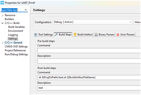

This works for me with CubeIDE 1.15.1:

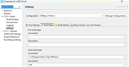

And this:
2024-09-23 8:40 PM
locations are not filled with FF, also shows error in crc calculation. Can u please share the command or script to be used. I am using stmcubeide 1.16.0
