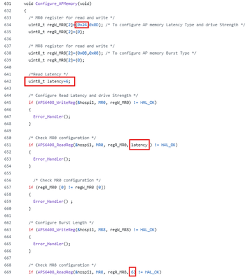

2025-09-04 11:36 PM
The regW_MR0[0] is 0x24, yet regR_MR0[0] is 0x88.
Clearly the XSPI bus timing has some issues.
Have a logic analyzer to see the exact transaction waveform on all XSPI bus,
this will give you the definite answer on the next step.
regards

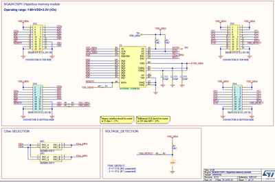

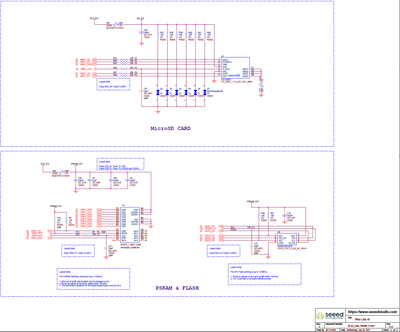

Furthermore, I purchased a Wio Lite AI board and realized there might be issues with my own board's design.
I have two reference designs: one from the MB1242 and another from the Wio Lite AI.
In both of these designs, the RESET pin is connected to VDD.
What is the purpose of this?
Is it necessary to add a series resistor and a capacitor to ground on the CLK line?
Doesn't this overcomplicate the design?
Should the Chip Enable (CE) pin be pulled up to the power supply via a resistor?
Is a 10μF capacitor in the power supply circuit a good idea?
Why are pins A2 and A5 connected to the power supply circuit in the MB1242 design?

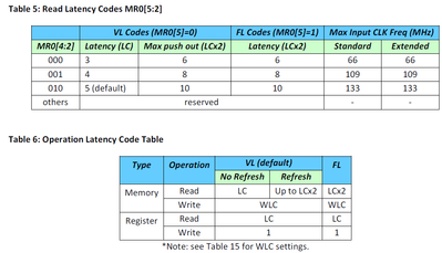

2026-03-26 3:17 AM - edited 2026-03-26 3:18 AM
Hi @Maxim357 ,
Some suggestions for your reference:
1. Set the correct Read Latency when MR read (according to the clock frequency)
For the sample code: Projects/STM32U575I-EV/Examples/OCTOSPI/OSPI_PSRAM_MemoryMapped/Src/main.c
regW_MR0[0]==0x24 -> Read Latency Code (LC) = 4 (clock <= 109MHz)
"uint8_t latency" should be set 4 if clock <= 109MHz
Please use low speed clock (ex: 50MHz) to test first.
