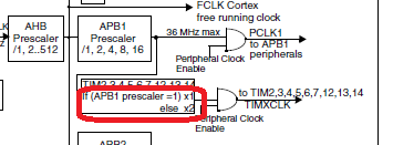

I am using STM32F103R6 for a motor control application.
STM states that the APB 1 frequency limit is 36 MHz, but I am using it with 72MHz and it looks like that all peripherals work fine. What risk am I taking? Is there a particular peripheral that need this limit?Has already someone experienced something like this?Thanks in advance,Marco #core-peripheral-clock #clock-config2013-10-01 12:58 PM

The timers can run at 72 MHz if the APB is at 36 MHz, what are you running that needs to be at 72 MHz? It's not going to catch on fire, the likely result is that data will be clock incorrectly over temperature.2013-10-10 1:24 AM

How can I run the timers at 72MHz while clocking them with a bus at 36MHz?As far as I know the prescaler can only divide the input frequency.Thanks,2013-10-10 1:25 AM

If you run the APB1 at 36 MHz, then the TIMCLK will still be at 72 MHz, please review the Clock Tree.We’re moving the ST Community to a new platform to give you a better and more reliable community experience.
