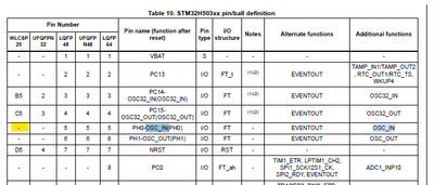

2025-07-18 11:40 AM
Looking at this a bit more, although the WLCSP25 package allows for CAN on some pins, it does not appear to have any high-speed clock input pins, which you probably need for CAN...

2025-07-18 12:00 PM - edited 2025-07-18 12:04 PM
There's no OSC_IN pin for this package, CAN usually requires a precise and stable clock, better than what the internal clocks (HSI, CSI, LSI) can do.
