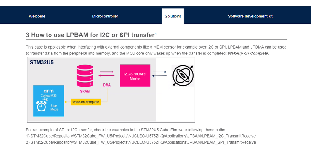

Let me know if This public AN is covering the need ? Enhanced methods to handle SPI communication on STM32 devices - Application note
Autonomous mode using LPBAM on U5 series need to cover indeed ! with an SPI example
