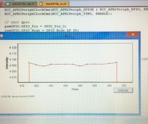

Hello! I need an advice. My stm32f103cb chip has ADC with 0.39 us per point conversion rate on one channel. But datasheet says its max rate is 1 Msps (1us). I checked sampling rate with external oscillograph (1 Gsps Tektronics) and external signal generator (Tektronics). I sent to ADC square wave with width of 10 us ON and of 10 us OFF (0-3V) and recieve with my delphi programm also square signal with flat level ON and OFF for 26 points of each. Also I was able to view sine wave signal up to 200 kHz (0-3V) with good resolution. The code is below. The basis was USB-CDC loop example from latest stmm32f1xx perif library. On EP3 event my parser starts GetData function where firstly resets DMA to set Memory base address to start of data array and then starts ADC conversion with direct DMA to record adc data to my array [992 elements] (dma mode is normal, not cyclic). After transfer is done - all data sends to usb-com and my delphi programm recieve it and plots a graph.

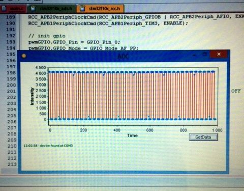

Uploaded some photos to my previous post.

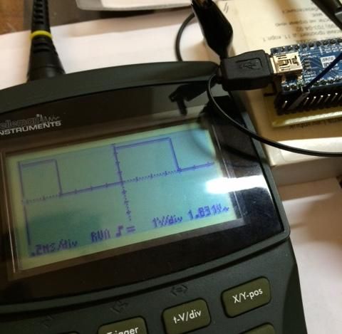

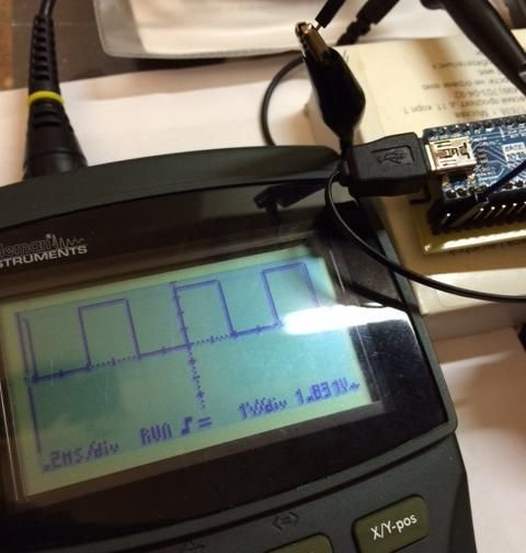

A little comments. I started TIM3 timer inside code to generate square pulses with 5 us width:
pwm.TIM_Prescaler = 36 - 1;
pwm.TIM_Period = 19;
pwmOC.TIM_Pulse = 10;
and connected TIM output via wire to adc input. My home DSO shows 5 us pulses and in my Delphi programm I see 13 points per pulse = 5 / 13 = 0.38 us resolution 0690X000006034VQAQ.jpg 0690X0000060382QAA.jpg 0690X0000060387QAA.jpg

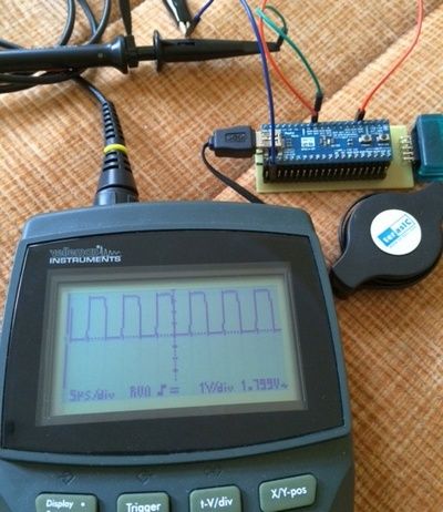

Posted on March 12, 2016 at 18:39
Thanks clive to reply!
Here is my test with toggle pin after cyclic DMA transfer of 1000 bytes fron ADC 0690X00000602rvQAA.jpg The time of one transfer if about 400 us so 1 sampling is 400 us / 1000 = 0.4 us. The code is here:
// test for 1000 ADC sampling via DMA, after TC toggle Pin

One interesting thing I found - if to comment these calls:
Set_System();
Set_USBClock();
USB_Interrupts_Config();
USB_Init();
then the results is: 0690X0000060388QAA.jpg 800 us / 1000 samples = 0.8 us that is close to 1Msps. So USB settings change something to increase ADC? Or maybe here is something that I missed?
