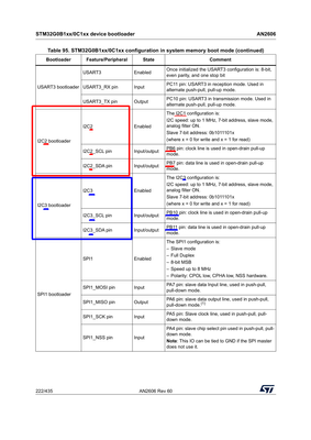

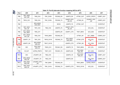

Hi @waclawek.jan ,
I confirm the typo in AN2606, for STM32G0B1, the Bootloader supports I2C1 and I2C2.
This issue is already reported internally.
Internal ticket number: 164780 (This is an internal tracking number and is not accessible or usable by customers).
Thank you.
Kaouthar

2023-12-15 4:43 AM - edited 2024-01-04 5:33 AM
Hi @waclawek.jan ,
Thank you.
Kaouthar

2024-05-02 7:26 AM
Hi @waclawek.jan ,
This issue is fixed in AN2606 Rev62.
Thank you for your contribution in STCommunity.
Kaouthar
