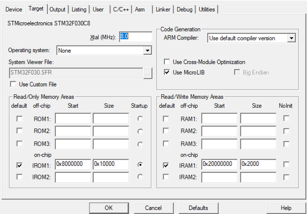

I have a STM32f030c8t6 which has 64kbyte FLASH. I've compiled my code before and I can see that only 34Kbyte is used.
now I want to develop my code.
I have a timer which interrupts every 4ms. entering timer interrupt, I have a function which is just a switch()/case with 15 cases. when I add 6 more cases I get below error
"...Error: L6406E: No space in execution regions with .ANY selector matching ...."
which is indicting that I do not have enough space in FLASH.
why is that? I mean, the code size was 33Kbytes, how can adding some more cases consume all of FLASH?

What I mean is that if you didn't use sprintf anywhere else in your code, and you added a one line case statement using it, then the linker might need to pull in several KB of code to facilitate that call that itself encodes to a few dozen bytes.
If nothing calls large sections of your code the linker discards it, until you create a dependency on it. Then it all has to come in.
2022-07-30 4:48 AM
The error message for the size exceeding evaluation limits is different.
This error comes from exceeding the bounds of the scatter file or linker script for a memory region.

The .MAP file (or verbose linker output) should be able to break down usage.
One trick to get closure is to make the FLASH section larger than the device's resources, now while the binary won't be usable it will allow the linker to complete in a way you can analyze/review the output.
Keil can decompose .AXF (ELF format) files with the FromELF tool, this can also disassemble and dump via FromELF -csd filename.elf >filename.lst
