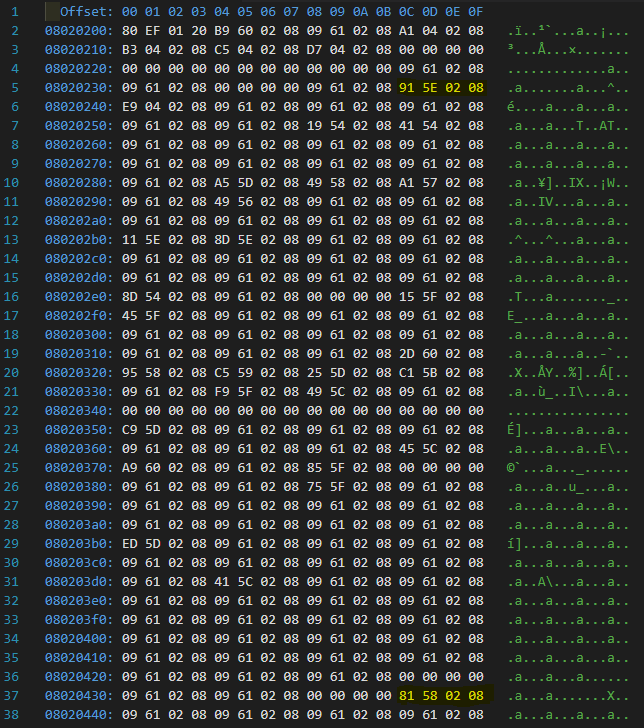

2024-09-05 12:20 AM
The active exeption at this breakpoint is the ADC3 interrupt and the VTOR value seems to align with the observed vector table offset:
The vector table entries for SysTick_Handler and ADC3_IRQHandler are highlighted.
2024-09-05 6:18 AM
143 - 15 = 128. So it's off by 128, I'm sure that's not a coincidence.
I would say that's an issue with SCB->VTOR not being set to a multiple of the vector table length.
If my interpretation of your screenshot is correct, you have SCB->VTOR = 0x08020200. Perhaps this isn't valid and it needs to be a multiple of 0x400. I'm not going to dig into documentation but that seems probable given the symptoms. Try 0x08020000 or 0x08020400.
2024-09-05 6:41 AM
0x08020400 worked, thanks! :)
