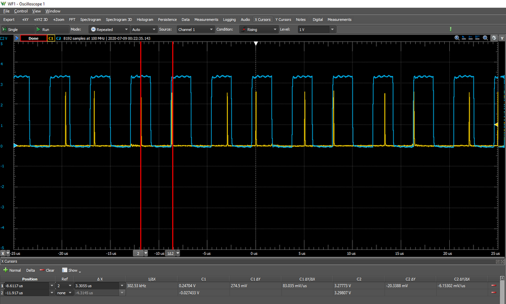

Second issue is that i see that GPIO toggle (BSRR used) in HAL_ADC_ConvCpltCallback is not in sync with HRTIMER edges and it varies from cycle to cycle. (blue is PWM from HRTIMER, yellow is GPIO toggle after ADC callback)

It looks like the period between triggers is around a little under 5us. So you're generating the HAL_ADC_ConvCpltCallback for each conversion at a rate of 200kHz. It's possible the CPU just can't keep up.
Slow the triggers down by a factor of 10 and try again.
