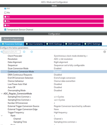

I am using NUCLEO-G071RB. I use 2 ADC channels: GPIO analog and internal temperature sensor. I connect the +3.3V to the GPIO analog pin via. potentiometer. The internal temperature looks like it works well (the temperature rises slightly when I put a finger on the MCU), but the GPIO analog give constant value, no mater what is the analog voltage attached to it (the voltage is monitored using oscilloscope)
The configuration:
My code:
