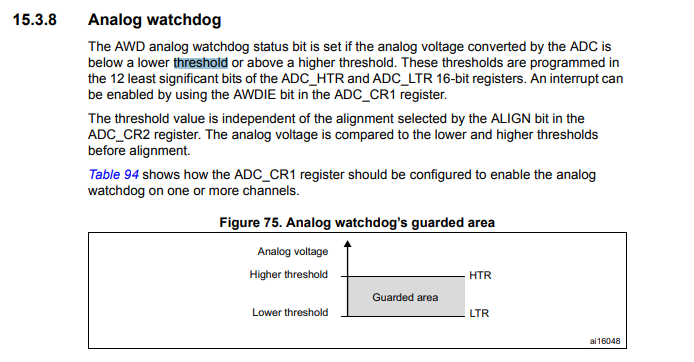

Hi @PSmol.1 ,
Can you check the higher and lower threshold of the analog watchdog ?
If you get the analog watchdog interrupt, it means that the value is below the lower threshold or above the higher threshold value.
Please find attached the corresponding Reference Manual.

Thanks for your response!
The lower threshold is 0, meaning it is a given that the upper threshold was triggered.

2022-10-03 8:30 AM
Once the analog watchdog triggered :
Thanks
A.MVE
