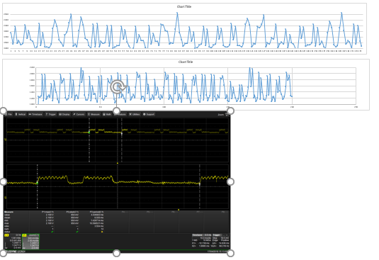

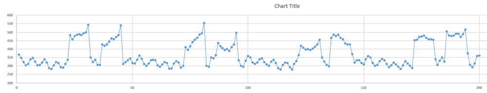

Given below is the expected (oscilloscope) and actual plotted graphs (excel graphs which are no where close to expectations)

Thanks for the reply AvaTar, So what strategy do u recommend? this STM32 can go upto 4MBps but that also doesnt help. Receiving at 2MBps baud rate gives a better graph (given below) but still no where near to what i expect.
