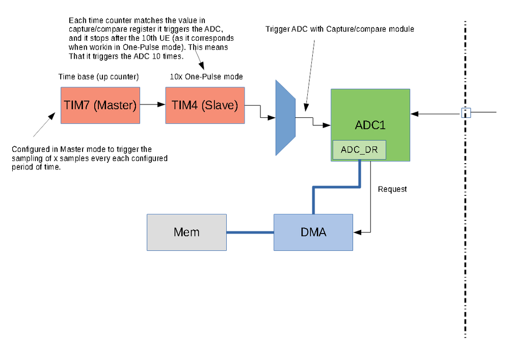

I need to control the ADC in a STM32F769 MCU to take a bunch of samples after a period of time (this acquisition is repeated over time). My idea is to use one timer as a counter and as master controller of another timer. This second timer would be configured as One-shot so it can take x samples (x One-shot times). Each one-shot should then trigger the ADC and at the end of conversion the DMA would have to take the sample and put it in a buffer in the memory automatically.
To give an intuition of this previously description I attach a pdf with a schematic of what I want to do.

2018-03-01 12:21 AM
Hi Clive,
thanks for your replies. I think now understand your idea. Take a look at the attached image, is this the configuration you are trying to explain??
