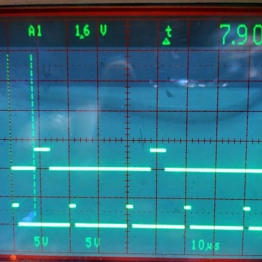

ADC triggering appears to be at half the frequency of the timer, (ie occurs every 2 update events), is this expected ?
This is with a STM32F334 progammed using HAL and with code generated by CubeMX.
I am reading 14 ADC channels using DMA (2x7 in simultaneous sampling), with interrupt at end of all conversions (HAL_ADC_ConvCpltCallback), values are found correct in the DMA buffer.
In the attached first picture, the top trace is the duration of the interrupt routine (level is high while in the routine), the bottom trace is channel 3 of TIM2 as PWM (2us every 20us), channel 1 of TIM2 update event being used as the TRGO source for the ADC. 7,9us is the conversion time from update event.

Thanks for your thoughts Clive, found it:
I had specified twice the count of DMA items, the interrupt is actually a "DMA finished" interrupt and is only called once all the items are transfered.
The "reason" for specifying twice the count is that to setup the DMA and start the ADC, I was calling HAL_ADCEx_MultiModeStart_DMA and specifed the size of the buffer in terms of uint16_t as if it where for a single channel DMA, the second argument of HAL_ADCEx_MultiModeStart_DMA is a uint32_t* which should have given me a clue that a count of 32 bit words was expected for DMA in dual simultaneous mode.
Specifying twice the count made the DMA clobber the memory after the buffer, ouch!
