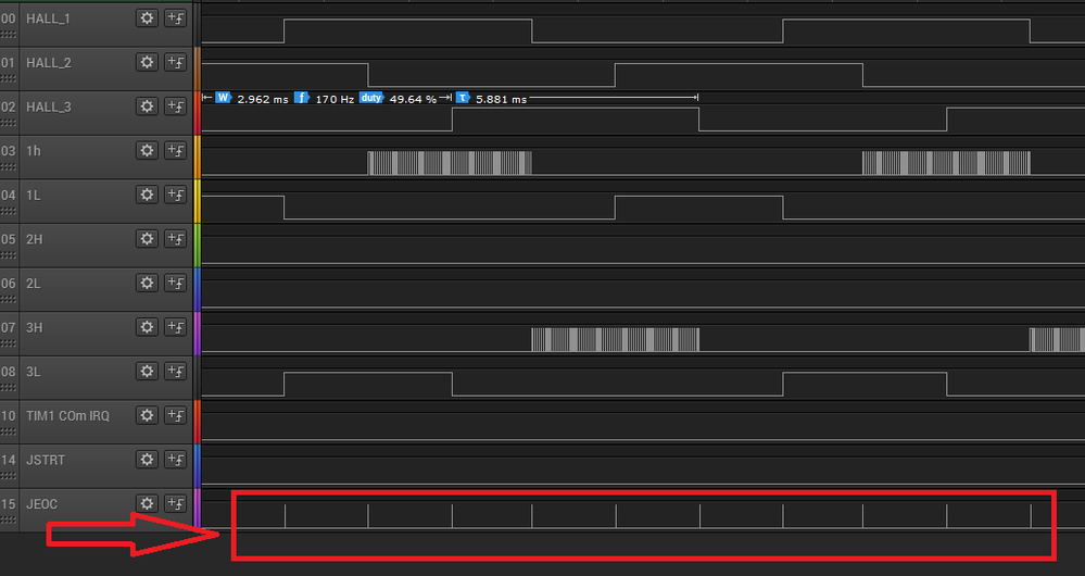

ADC_ClearITPendingBit(ADC1, ADC_IT_JEOC);// Clear ADC1 JEOC pending interrupt bit }On the logic analyzer i can see its toggles , but i tryied to read and convert the value in voltage, and i get 3.2v, 2.6V, and 0.2V ...
As seen this on the logic capture, i fear that the adc is trigerd at every hall event, and not at the midle of a pwm ''on cycle''. How to overcome this?
Since i am not familiar with usage of adc injecte mode, i fear i am doing something wrong
