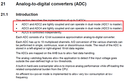

You need to refer to the reference manual RM0440 for that:
From ADC introduction:
The modes are described in the ADC section:

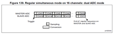

ADC1 and ADC2 can work together in Dual mode in specifically in "Regular simultaneous mode":
See figure 139:
See figure 139:
Triple mode is not available on this product.
Hope I answered your question

The simultaneous mode is described in the RM, you can measure only two channels at time T with two ADCs.

This is not a simultaneous conversion. It's a done successively ... and can be done by 2 ADCs in DUAL mode.
I've already shared a figure from the RM that fits your needs ..
