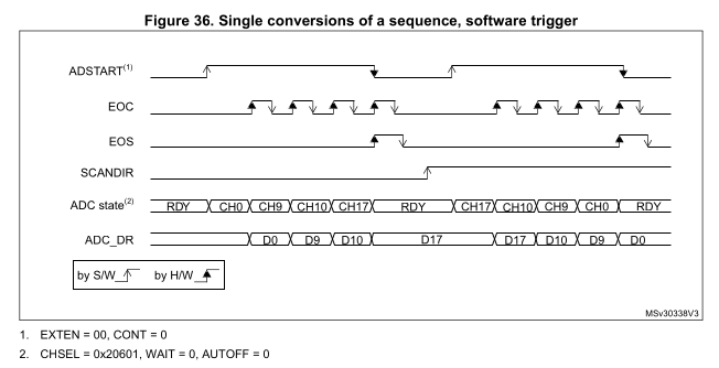

I think you are partially correct. If I increase the sample time to 19.5 ADC Clock cycles 2 EOC events happen for each EOS event. I think there should be 3 EOC events, see the diagram, but it's an improvement. Also the data register now holds the data corresponding to the last channel in the sequence which is nice.

In any case 3 EOC events are generated but since the total interrupt handling time is now approx. > 2 x conversion time, you miss one event and the ISR is fired 2 times after the chage (was fired only once before).
