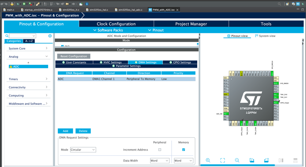

2024-05-04 9:03 AM
- don't set ADC continuous...
- don't start DMA 2x
- set DMA circular mode
So it will run all the time.

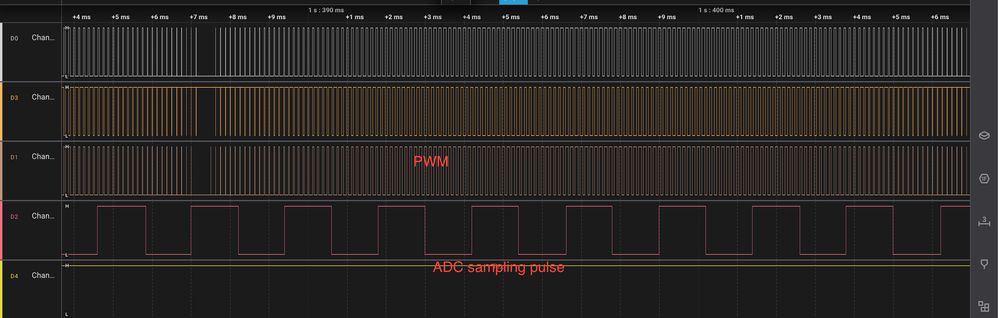

Here is i think my ADC is not getting triger from Time how to check it ?
You start ADC with trigger - so if it converts you see it - right ? otherwise no result/output.

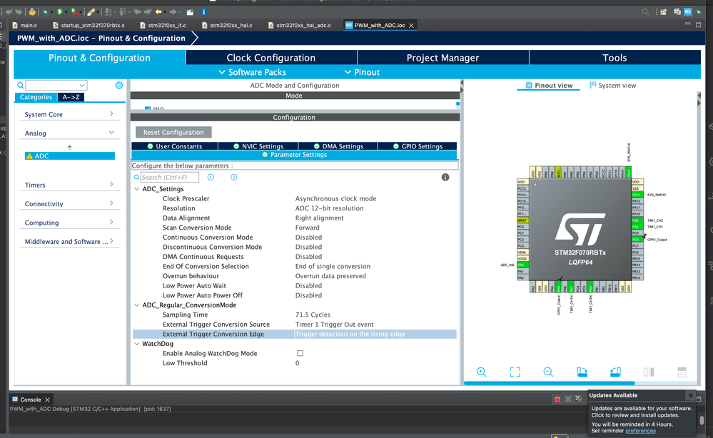

hadc.Instance = ADC1;
hadc.Init.ClockPrescaler = ADC_CLOCK_ASYNC_DIV1;
hadc.Init.Resolution = ADC_RESOLUTION_12B;
hadc.Init.DataAlign = ADC_DATAALIGN_RIGHT;
hadc.Init.ScanConvMode = ADC_SCAN_DIRECTION_FORWARD;
hadc.Init.EOCSelection = ADC_EOC_SINGLE_CONV;
hadc.Init.LowPowerAutoWait = DISABLE;
hadc.Init.LowPowerAutoPowerOff = DISABLE;
hadc.Init.ContinuousConvMode = DISABLE;
hadc.Init.DiscontinuousConvMode = DISABLE;
hadc.Init.ExternalTrigConv = ADC_EXTERNALTRIGCONV_T1_TRGO;
hadc.Init.ExternalTrigConvEdge = ADC_EXTERNALTRIGCONVEDGE_RISING;
hadc.Init.DMAContinuousRequests = DISABLE;
hadc.Init.Overrun = ADC_OVR_DATA_PRESERVED;

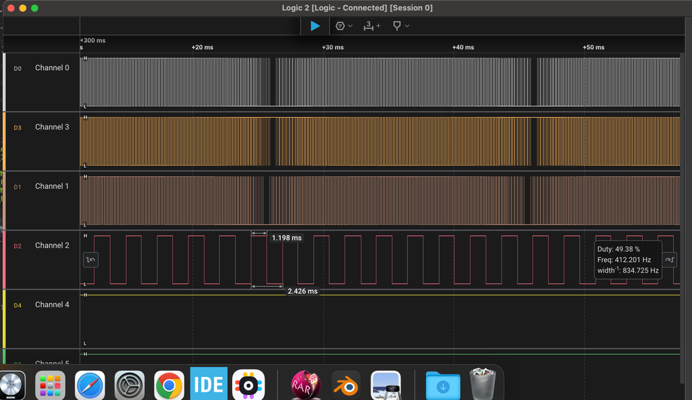

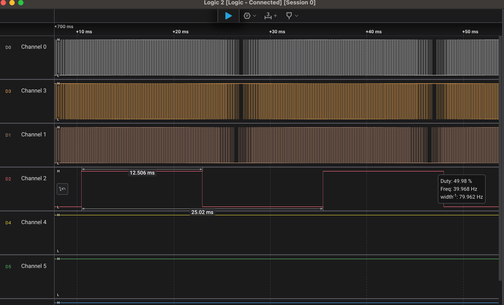

When I enable DMA contnious request the ADC is sample some of frquency as follows 12.506 ms second sample
when i use conntinus DMA request + continous Conversion the following sampling getting
Please help me correct it ?
