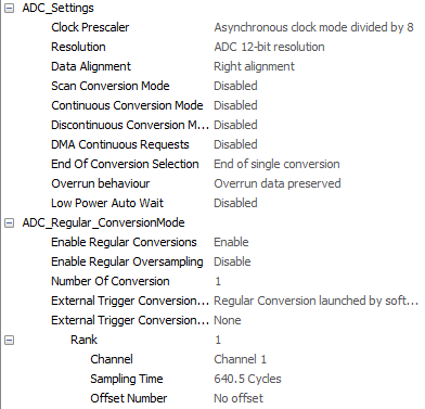

HCLK is set for 80MHz, ADC settings are below:
