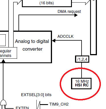

You should perhaps make sure that the HSI is enabled and running.

I made the following changes to ensure HSI is enabled:
  if(RCC_GetFlagStatus(RCC_FLAG_HSIRDY) == RESET){
      // Enable HSI Clock and wait until it's ready
      RCC_HSICmd(ENABLE);
      while(RCC_GetFlagStatus(RCC_FLAG_HSIRDY) == RESET);
still same old problems. Thank you for taking the time to help me out. I'm not sure what other information would be helpful to solve this problem, but I wonder if it has to do with calibration? I read on another forum that this may be done automatically though, so perhaps my problem is sampling rate, or something stupid like type mismatching. IAR still says that 'result' is unavailable, and never gets set, not even to 0.

Test this on an STM32L-Discovery, verified with PA1 attached to VDD and then GND and observed full scale measurements. Attempted to recreate your configuration using code from my own trees.
// sourcer32@gmail.com - STM32L15x ADC Demo (PA.1 Channel 1)
// Built in Keil against STM32L1xx_StdPeriph_Lib_V1.1.1
#include ''stm32l1xx.h''
#include <
stdio.h
int main(void)
GPIO_InitTypeDef GPIO_InitStructure;
ADC_CommonInitTypeDef ADC_CommonInitStructure;
ADC_InitTypeDef ADC_InitStructure;
/*!< At this stage the microcontroller clock setting is already configured,
this is done through SystemInit() function which is called from startup
file (startup_stm32l1xx_xx.s) before to branch to application main.
To reconfigure the default setting of SystemInit() function, refer to
system_stm32l1xx.c file
RCC_AHBPeriphClockCmd(RCC_AHBPeriph_GPIOA | RCC_AHBPeriph_GPIOB, ENABLE);
GPIO_InitStructure.GPIO_Pin = GPIO_Pin_15;
GPIO_InitStructure.GPIO_Mode = GPIO_Mode_OUT;
GPIO_InitStructure.GPIO_OType = GPIO_OType_OD;
GPIO_InitStructure.GPIO_PuPd = GPIO_PuPd_NOPULL;
GPIO_InitStructure.GPIO_Speed = GPIO_Speed_40MHz;
GPIO_Init(GPIOB, &GPIO_InitStructure);
GPIO_ResetBits(GPIOB,GPIO_Pin_15); // PB15 Low
GPIO_InitStructure.GPIO_Pin = GPIO_Pin_1;
GPIO_InitStructure.GPIO_Mode = GPIO_Mode_AN;
GPIO_Init(GPIOA, &GPIO_InitStructure);
/* Enable The HSI (16Mhz) */
RCC_HSICmd(ENABLE);
/* Check that HSI oscillator is ready */
/* ADC1 Configuration ------------------------------------------------------*/
/* Enable ADC1 clock */
RCC_APB2PeriphClockCmd(RCC_APB2Periph_ADC1, ENABLE);
/* Deinitialize ADC */
ADC_DeInit(ADC1);
ADC_CommonStructInit(&ADC_CommonInitStructure);
ADC_CommonInitStructure.ADC_Prescaler = ADC_Prescaler_Div4;
ADC_CommonInit(&ADC_CommonInitStructure);
/* ADC Configuration */
ADC_InitStructure.ADC_Resolution = ADC_Resolution_12b;
ADC_InitStructure.ADC_ScanConvMode = DISABLE; // Single channel
ADC_InitStructure.ADC_ContinuousConvMode = ENABLE; // Continuously back-to-back
ADC_InitStructure.ADC_ExternalTrigConvEdge = ADC_ExternalTrigConvEdge_None;
ADC_InitStructure.ADC_ExternalTrigConv = ADC_ExternalTrigConv_T2_CC2;
ADC_InitStructure.ADC_DataAlign = ADC_DataAlign_Right;
ADC_InitStructure.ADC_NbrOfConversion = 1;
ADC_Init(ADC1,&ADC_InitStructure);
/* ADC1 regular channel 1 for PA1 configuration */
ADC_RegularChannelConfig(ADC1, ADC_Channel_1, 1, ADC_SampleTime_192Cycles);
/* Enable ADC1 Power Down during Delay */
ADC_PowerDownCmd(ADC1, ADC_PowerDown_Idle_Delay, ENABLE);
/* Enable ADC1 */
ADC_Cmd(ADC1, ENABLE);
/* Wait until ADC1 ON status */
while(ADC_GetFlagStatus(ADC1, ADC_FLAG_ADONS) == RESET);
/* Start ADC1 Software Conversion */
ADC_SoftwareStartConv(ADC1);
/* Infinite loop */
while(1)
/* Wait until ADC Channel end of conversion */
while(ADC_GetFlagStatus(ADC1, ADC_FLAG_EOC) == RESET);
printf(''%04
X'', ADC_GetConversionValue(ADC1)); // STDIO via SWD/SWV code redacted
