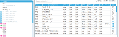

I'm having an issue with my STM32F303RE. I'm using CubeMX to initialize ADC1_IN1 as single ended on PA0, and PWM generation on TIM2_CH1 on PA15. Unfortunately, PA0 will OUTPUT a voltage roughly proportional with the duty cycle of the PWM on PA15, i.e. setting the PWM (again, supposed to be on PA15) to 50% duty cycle results in about 1.5V on PA0. The PWM on PA15 is generated correctly. The PA0 voltage looks like a noisy but constant signal, it doesn't have the PWM signal "shape". PA0 is itself compatible with TIM2_CH1, so I guess something is bleeding over somewhere. Please help me fix this programmatically, I'm really not keen on redoing my circuit.

PA0 is connected to the current sense (IPROPI) pin of a DRV8251A motor driver, incidentally driven from the PWM of TIM2 on PA15 and PB3. The motor driver is supposed down if the current is too high, and I suspect that setting a voltage on the current sense pin is interpreted as just that.
As far as I can see, though, the problem here is the bleeding of TIM2_CH1's PWM onto the wrong pin. The same setup (driver, ADC, PWM) works just fine for TIM15 (PA2, PA3) and ADC2 (PA4), and I'm observing the same failure mode on two identical PCB's -- so I don't think anything's fried.

Which leads me to my followup: how can I check the register values? As I mentioned, the same setup works fine for a different combination of timer/adc/pins, so if anything it's CubeMX messing up the code generation (I'm using the makefile setting and programming in vscode fwiw). The init functions seem to be correct in that all the config information from the CubeMX GUI is carried over to the relevant init functions for ADC and PWM as far as I can see, but I haven't been able to go any deeper than that. Setting the ADC/PA0 pin to RESET_STATE in the GUI does remove the problem.
