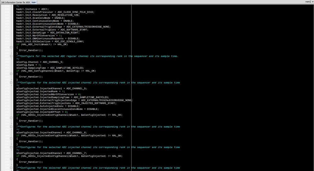

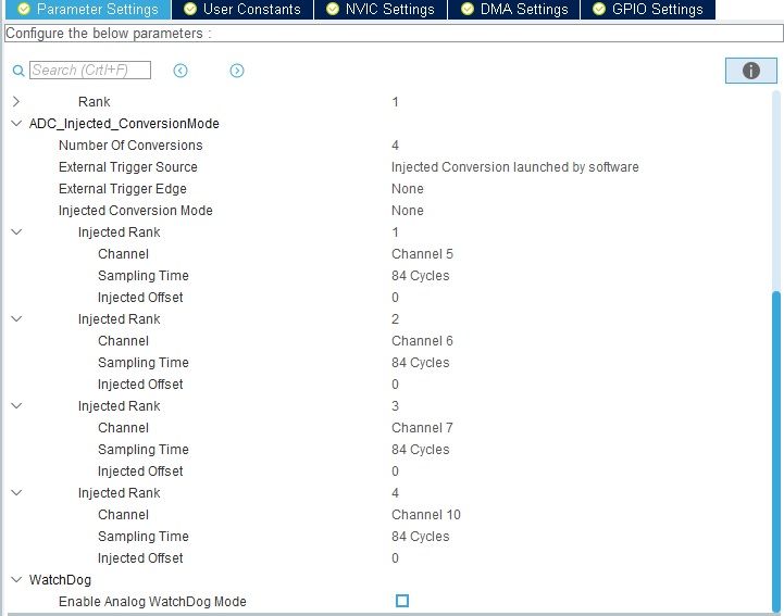

Here is the mine configuration. I changed Sample time value but no changes.
