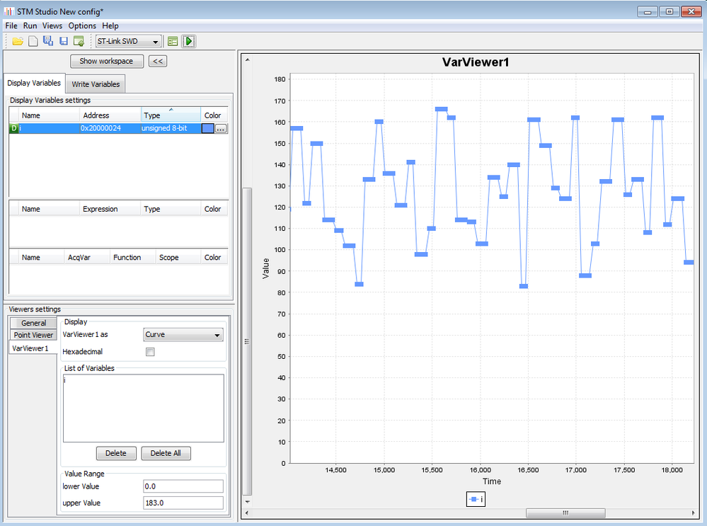

Thanks for all you explanation.Obviously, I am confronted to a new problem : I test the output ADC's values. I send to PC2 an signal between 0 and 1 volt -don't consider impedance issue, and it is not a sampling frequency issue- I check the voltage value on PC2 with a voltmeter.I look converted values with STMStudio for example, but I obtain funky values (It seems to be random values)...Let's have a look of this :2013-07-30 8:40 AM
I don't know how you are generating the 8-bit value you are watching. If you are getting a lot of variability you could increase the ADC's sample time cycles.
