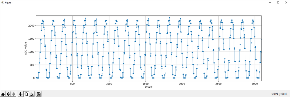

ADC_REGOVERSAMPLING_CONTINUED_MODE;Here is how I configured my ADC for continuous conversion using DMA. The issue of "clumpy" data is present in debugger mode in my adc buffer.
The ADC is started with the HAL call:
HAL_ADC_Start_DMA(&hadc4, (uint32_t*)adc_buf, ADC_BUF_LEN);where adc_buf is a uint16_t buffer of length ADC_BUF_LEN (4096).
Regardless of the method to get the values out, I'm using adc_buf as a ping-pong buffer, the values in the buffer are clumped. Here's an image of my ADC reading a 20Hz signal that has 5Vpp amplitude and is offset by 2.5V. The Vref- is 0V and Vref+ is 5V.
I would love any help that regards a way to make the data points more spread out and continuous looking. Each point in the shown graph is 6-10 individual data points.
Also interestingly the ADC values are not being maxed even though I am at the Vref+ value at the top of the wave.

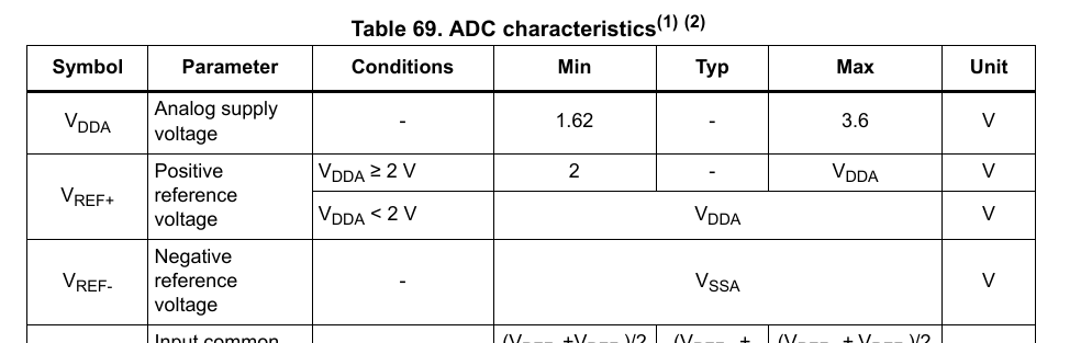

You can damage IC applying Vref > Vdd. Read data sheet attentively.

The board seems all good with testing. It turns out the hardware I'm using has a voltage divider and voltage clamp that turned the 10V I inputted into 2.8V. Also, Vref is 3.3V and not 5V as I thought. Your responses made me delve deeper into the schematic, so thank you.

Good. Anyway, distortions seen on picture indicate "overdrive" ADC at ground level.
It could happened if sinewave not properly biased to 1.65V, show your driver circuits.
