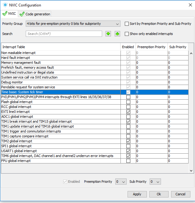

2018-11-13 5:37 PM
Look
2018-11-14 10:17 AM
That's my NVIC configuration. I'm still having issues with the ADC after the delay.
2018-11-14 1:08 PM
What status is HAL_ADC_PollForConversion() returning when it fails (edit: change you code so that you DO check the return status, don't assume is works)? If that doesn't clear things up, use your debugger and single-step through the HAL_ADC_PollForConversion() function to see why it is failing.
2018-11-14 3:20 PM
Ok, and didn't I say that everything other than SysTick needs a priority >= 1
You're trying to ensure SysTick can interrupt whatever else is running/blocking, this isn't going to happen if everyone is set to zero. You'll spin in a loop and the tick count will never go up.
