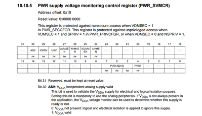

I've identified the root cause of my ADC issue related to FreeRTOS. It turns out that the ASV bit in the PWR->SVMCR register was never enabled during the initialization phase. This bit is essential for the proper operation of analog peripherals ... I suggest that this step be included in the HAL initialization code in future updates .

The "HAL_PWREx_EnableVddA()" must be invoked in "stm32u5xx_hal_msp.c" when activating ADCx.
This issue is internally tracked with the ID: 176661, and a fix is planned for the upcoming version.
