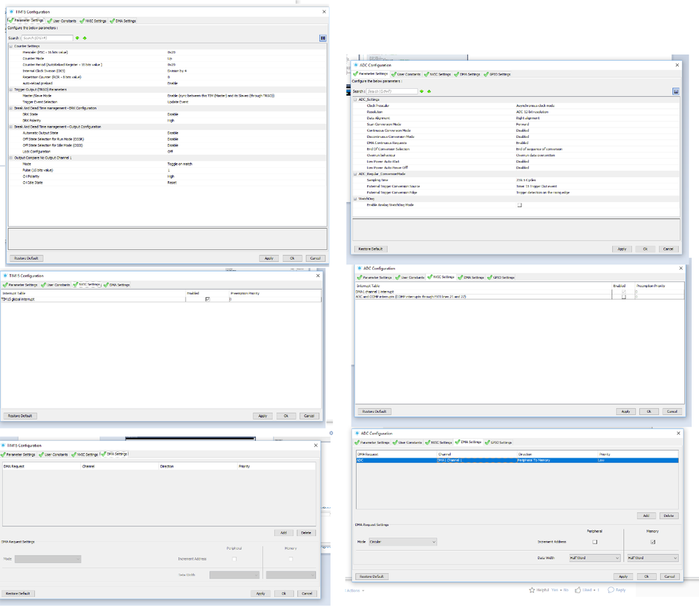

Posted on March 26, 2018 at 07:18
here is my startup code for the ADC, using timer15
    start_Timer15();
    ADC_RowCounter = 0;
    Ave_ADC_ChannelCounter = 0;
    ADC_ChannelsCounter = ADC_ChannelCount;          // 15 ADC channels
    HAL_ADC_Start_DMA(&hadc, (uint32_t *)ADC_DMABuffer, ADC_ChannelCount);0690X0000060ACHQA2.png
