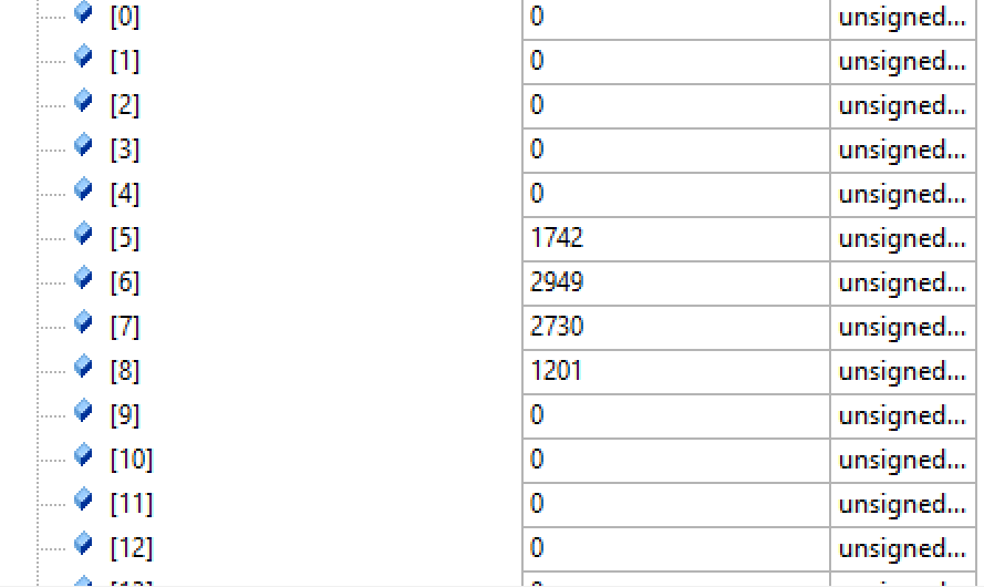

2019-03-21 7:10 AM
It seems TIMER2 doesn't trigger the ADC using a Trigger update. I switched to Timer 1 and that seemed to solve my issue. However, I'm now facing another issue. The buffer isn't filled and some samples are missing
WOuld it be better to open another thread?
