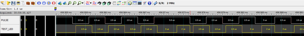

}I was confusing why the pulse sometimes ARR should be reload (pulse 5.5us)but it didn't, but from the picture of waveform , I can still see the compare interrupt(TEST_LED 2us) still work.

Is your logic analyzer fast enough to display a pulse 1 cycle long? And is the PWM output pin set fast enough in GPIO_CRx.MODEx to output a pulse 1 cycle long?

As you see the top of my logic analyzer its sample rate is 2MHz, that means it shows every 1/2MHz( = 500ns).

The new things I found was, if I show TIM1(pulse generate) and TIM5(1ms loop) separately, then everything happened accurately. But when I put them together, then TIM1 and TIM5 affect each other, for instance, 1ms later become 1.001ms ~ 1.004ms, that would increase about 1~4us, 2us is large enough to make the interrupt of TIM1 delay.
