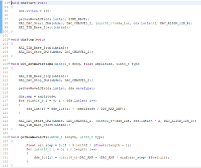

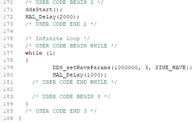

There is my code, and I'm referenced other sources.

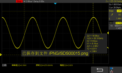

And this picture is my generated wave, the voltage is down 1v to 2v, and the frequency at 125kHz.

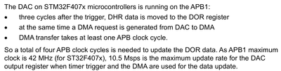

The DAC is not able to update at 90 MHz. Reduce the number of samples per period. Looks like it can do about 1/8 of what you want, so maybe shoot for an update rate of 10 MHz.
This app note suggests 10.5 Msps as the max rate. Might be slightly different for your chip.
It's going to be tough to get a clean 1 MHz without artifacts.
