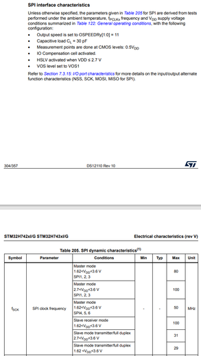

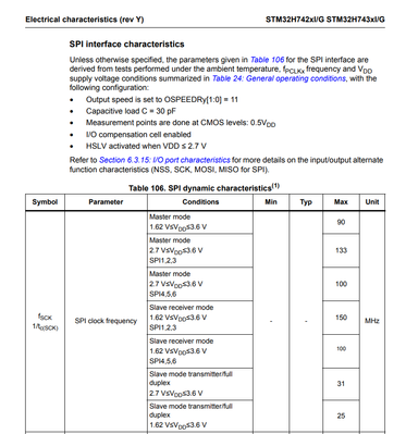

For example, for the STM32H743 revY, fSCK max is as shown in the below figure
For the STM32H743 revV, fSCK max is as shown in the below figure
For more information about the conditions and the maximum SPI clock frequency, I recommend you to look to the datasheet SPI interface characteristics section.
