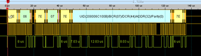

I do the ENTDAA protocol use this code
if (HAL_I3C_Ctrl_DynAddrAssign_IT(&hi3c1, 0) != HAL_OK)
/* Error_Handler() function is called when error occurs. */
Error_Handler();
In below picture , I get the ENTDAA Protocol, but After protocol there should be repect start and do End DAA procedure waveform. It always keep  ,pull up high after a few seconds.(ref three pic.
How can I do it?End DAA procedure waveform
Below picture is all protocol , no End DAA procedure waveform

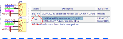

I change one sensor ,   it solved
I change jumpper on X-NUCLEO-IKS01A3 board
after ,it protocol is the same .
thank you very much.
Why can't multiple devices generate this protocol?
Foued_KH
The ENTDAA  not supported with the LPS22HH ( see datasheet ).
You need to use another way using SETDASA .
Foued
CLHUANG
Associate III
Dear Foued
Now I get it!  Thank you very much.
