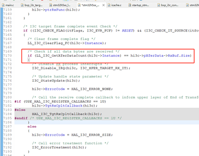

2024-04-08 1:22 AM
Hello @Imen.D
In my application , the target doesn't know the length of the received data.But this is not realistic in the HAL library.What should I do?
