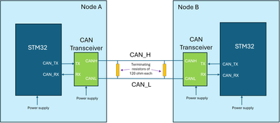

The issue issue not clear. what do you mean by "there is a phenomenon where I cannot send information"??
Do you mean you are not able to send CAN frames?
In that case you need to provide the following:
1- A sketch of your CAN bus. Like this:
2- Are you using stm32g473 nucleo board?
3- Share the schematics especially the CAN part.
4- Share your project so I can check your config
Please answer the questions above, otherwise, I cannot hep you efficiently.
PS: you didn't tell if you have connected another CAN node on the bus. If not. This is not the correct way to test the CAN interface in Normal mode. You need to use Loopback mode instead.
