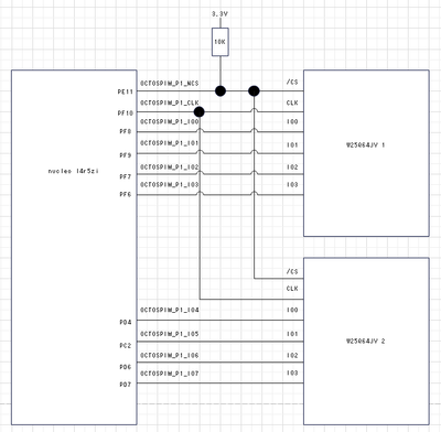

What I want to do is XIP with DUAL QUAD SPI.
The environment is as follows.
Use Board : nucleo l4r5zi
IDE : Atollic TrueSTUDIO® for STM32, Built on Eclipse Neon.1a.(Version: 9.3.0)
FLASH : W25Q64JV
The connection diagram of the board and FLASH is shown below.

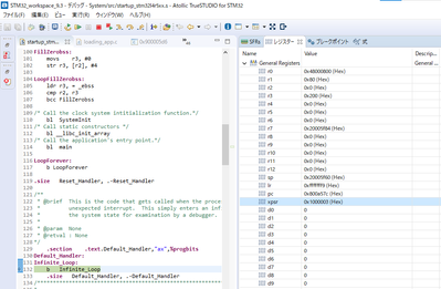

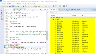

If a breakpoint is set at line 10 above and step execution is performed from there, a hardfault will occur.
I understand that a Hard Fault occurred because the 0~8 bits of XPSR are 3.
Register information when an exception occurs.

2024-02-24 4:24 AM
Hello @KDJEM.1 @Tesla DeLorean
As shown below, I pulled up CS and did Excute In Place using DUAL-QUAD-SPI as expected.

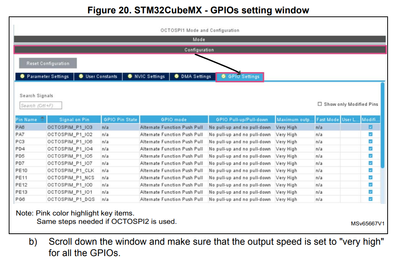

2024-02-27 12:14 AM
Hi @Myasu.1 ,
Could you please try to decrease the OCTOSPI frequency?
Also, please make sure that:
- All OCTOSPI GPIOs are set to very-high speed
- Disable the timeout feature
Thank you.
